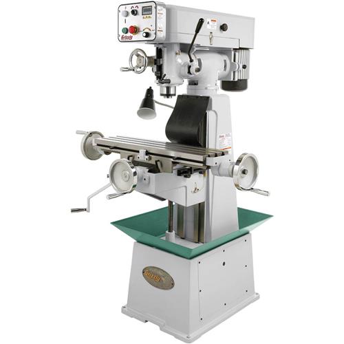

Description
This knee mill will be a fine addition to any home shop, school or job shop! Its outstanding features include fold up safety handles, one-shot lubrication, tilting head, fine down feed and last but certainly not least, infinitely variable spindle speed control with a digital tach! Now you can have speeds from 200 to 2250 RPM with just the turn of a dial. And it’s controlled by a state of the art Yaskawa frequency drive. No need for 3-phase here, folks! Hook it up to your 220 volt, single phase power source and go! The drive inverts and modulates the power to give you smooth speed changes with robust torque.
  • Motor: 1.5 HP, 220V, 3-phase
  • Spindle taper: R-8
  • Spindle travel: 3-1/2"
  • Table size: 8" x 30"
  • Table travel (longitudinal): 18"
  • Table travel (cross): 7-3/4"
  • Knee travel (vertical): 17-3/4"
  • Max. dist. spindle to table: 20"
  • Turret or column swivel: 360°
  • T-slots: 3 on 2-3/16" centers, 3/8" studs
  • Range of speeds: 200 to 2250 RPM
  • Number of spindle speeds: Variable
  • Overall height: 67"
  • Approximate shipping weight: 966 lbs.
  • Electronic variable spindle speed control
  • Reversing switch
  • Adjustable travel stops on X & Y
  • Fold up safety handles
  • One shot lubrication
  • Tilting head
  • Turret style column
  • Fine down feed on quill
  • Dovetail ways
