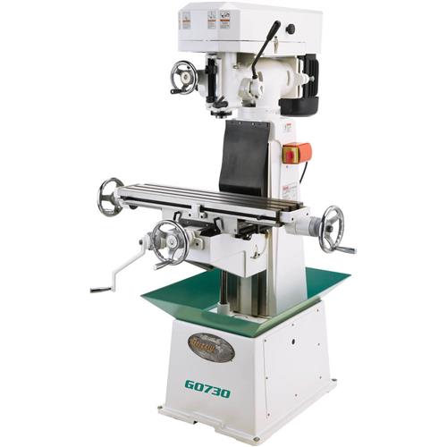

This 8" x 30" Vertical Milling Machine includes all the same features as its 6" x 26" little brother (G0728/G0729), but is constructed with a heavy, one-piece casting for even greater rigidity and an extra 300 pounds of mass. It also accommodates up to a 14" swing and 20" between table and spindle. Features a built-in drain and cabinet designed to accept aftermarket coolant systems, making it readily upgradable. Available with or without longitudinal power feed.
  • Dovetail sliding ways for accuracy
  • One-shot oiler lubrication system
  • Catch tray and drain allows for coolant system upgrade
  • Large stroke handle
  • Forward/Reverse switch
  • Rotating turret-style column
  • Head tilts side-to-side
  • Precision-ground table
  • Coarse and fine downfeed controls
  • Adjustable downfeed stop system
  • Motor: 1-1/2 HP, 110V/220V, prewired 110V, 1725 RPM
  • Power transfer: V-belt drive
  • Spindle taper: R-8
  • Spindle travel: 3-1/2"
  • Max. distance spindle to table: 20"
  • Max. distance spindle to column: 7"
  • T-Slots: 3 @ 2-3/16" on center, 1/2" wide
  • Table size: 30" L x 8" W
  • Table travel (longitudinal): 18"
  • Table travel (cross): 7-3/4"
  • Knee travel: 17-3/4"
  • Max. drilling capacity for cast iron: 1"
  • Head tilt: 45° left/right
  • Number of speeds: 9
  • Speeds: 270, 420, 490, 950, 1110, 1410, 1720, 2050 and 3200 RPM
  • Overall dimensions: 40-1/2" W x 67" H x 42-3/4" D
  • Approximate shipping weight: 964 lbs.
