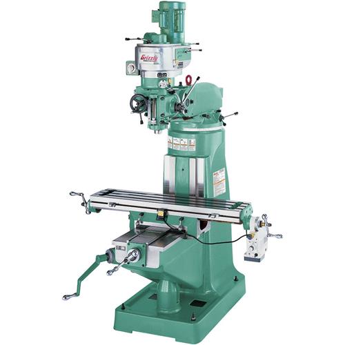

This is our most economical turret type knee mill with a 9" x 42" table. It has all the features that larger mills have like power down feed with auto-stop and return, longitudinal power feed and a 5" quill travel with a depth stop. The very heavy castings and large sliding surfaces give incredible performance and stability. And with the turret type head, the working capacities are quite large. Shop around, you won't find this kind of value in a mill of this type and size.
Features:
  • One-shot Pump Lubrication
  • Power Down Feed
  • Quill Feeds: 0.0019", 0.0035", 0.0058"
  • Auto Stop w/ Micro Adjustable Stop
  • R-8 Spindle
  • Longitudinal Power Feed
  • Hardened & Ground Table Surface
  • Chrome Plated, Precision Ground Quill
  • Adjustable Micrometer Depth Stop for Spindle
  • Spindle travel: 5"
  • Table size: 9" x 42"
  • Table travel (longitudinal): 25-7/8"
  • Table travel (cross): 12-1/2"
  • Max. dist. spindle to table: 18"
  • Max. dist. spindle to column: 20"
  • Knee travel: 16"
  • Head tilt: 45 degrees both ways
  • Head swivel: 90 degrees both ways
  • T-slots: T-slots: Three 5/8" slots, 2-1/2" on center
  • Range of speeds (RPM): 78, 98, 197, 278, 670, 850, 1700 and 2400
  • Motor: 2 HP, Single Phase
  • Base footprintL 36" x 24"
  • Approximate shipping weight: 2379 lbs.
