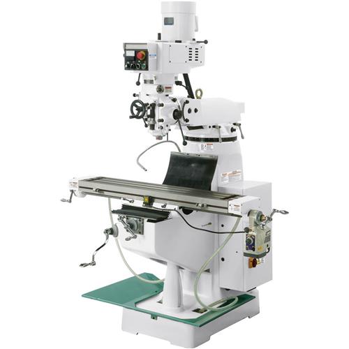

This is the cream of Taiwanese mills and it’s packed with the features all machinists love! Start with Meehanite castings, high class spindle bearings, hardened and ground lead screws with double bronze nuts and a chromed quill with precision honed housing! Now add an electronic variable speed spindle motor and you’ve got yourself one serious milling machine. Check out the other incredible features and you’ll agree, this is the cream of the crop.
  • Motor 3 HP, 220V/440V, 3-phase, 8.5/4.25 Amps RPM 1725
  • Power transfer Cogged belt
  • Spindle taper R-8
  • Spindle travel 5"
  • Table size 9" x 48"
  • Table travel (longitudinal) 29"
  • Table travel (cross) 12"
  • Knee travel (vertical) 16"
  • Ram travel 13"
  • Ram swivel 360°
  • Max. dist. spindle to table 18"
  • Head swivel 90° & 45° front to back
  • T-slots 3 on 2-1/2" centers, 1/2" stud
  • Spindle speeds Variable
  • Range of speeds 50-575, 575-5000 RPM
  • Spindle feed 0.0015", 0.003", 0.006"
  • Quill diameter 3.35"Overall dimensions 57"L x 71"W x 87-1/2"H
  • Approximate shipping weight 2420 lbs.
Features:
  • Runs on 220V, single-phase power with 5 HP inverter
  • One shot pump lubrication
  • Power down feed
  • Auto stop with micro adjustable stop
  • Longitudinal power feed with 135 in/lbs of torque
  • High precision spindle with P4 class angular contact ball bearings
  • Chromed quill and honed housing
  • Precision hand scraped slideway
  • Double bronze nut on X and Y leadscrew
  • Hardened and precision ground lead screws
  • Multiple saddle knee table and ram locks for high rigidity
  • Heavy-duty spindle brake
  • Adjustable gibs
  • Built-in coolant tank in base casting
  • All spindle and head components are dynamically balanced for reduced vibration
  • Way chip protectors
  • Hardened precision ground cast iron table
  • Chromed steel spindle housing
  • Column, head and knee saddle construction: Meehanite castings
