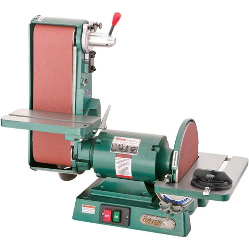

G1183 6" x 48" Belt/12" Disc Combo Sander
A sander built to the scale and level of quality professional woodworkers demand.
The heavy-duty G1183 6" x 48" Belt/12" Disc Combo Sander features a sanding belt that operates horizontally, vertically or at any angle in between and a 12" disc.
The sanding belt speed is 5000 FPM and the disc speed is 3450 RPM.
Both cast-iron tables tilt for any job. The belt sander table tilts 90° while the disc sander table tilts 30° left and 45° to the right.
The convenient, quick-release lever makes tension adjustment and belt changes and a snap. There is a full range of replacement replacement belts and sanding discs for the G1183.
Belt rollers have shielded ball bearings and the top roller has a fine-tuning knob for precision tracking.
The base accepts 5/8" fasteners for mounting to workbench.
The G1183 manual was written by our U.S.-based Technical Documentation Department and is packed with useful information. The complete and easy-to-read manual makes it easier to assemble and maintain your sander.
  • Motor: 1 HP, 110V/220V (prewired for 110V), single-phase, 12A/6A
  • Sanding belt size: 6" x 48"
  • Sanding belt speed: 5000 FPM
  • Belt platen size: 6" x 14-1/2"
  • Belt table size: 7" x 12-1/2"
  • Disc diameter: 12"
  • Disc backing type: PSA
  • Disc speed: 3450 RPM
  • Disc table size: 7" x 16-1/2"
  • Table tilt 30° L, 45° R
  • Number of dust ports: 2
  • Dust port sizes: 2-1/2", 3"
  • Footprint: 17" x 14"
  • Overall dimensions: 32-1/2" W x 16-1/2" D x 29-1/2" H
  • Approximate shipping weight: 148 lbs.
  • For woodworking and metalworking
  • Quick belt release
  • Disc table positive stops at 90°
  • Belt table positive stops at 45° and 90°
  • Two cast-iron tables
  • Top roller has fine tracking knob
  • Miter gauge
We offer U.S.-based customer service and technical support to get your questions answered and help keep your equipment running in top condition. And to ensure your satisfaction, the G1183 comes with a 1-year warranty.
