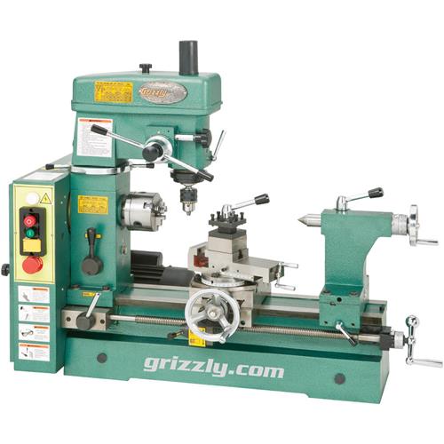

We took our basic combination Metal Lathe/Milling Machine and increased its capacity and usability. Start with a lathe spindle bore of 3/4" and a longer bed. Then added more change gears, inch-cut lead screws, a 4" 3-jaw chuck, reversing switch and so much more. This is an excellent machine for anyone, from the home hobbyist to the seasoned machinist. You get a lot of machine in a very small package with all the features you need for just about any job!T-slots in cross slide Cuts inch & metric threads Turret tool post 4" 3-jaw chuck Tailstock offsets 1/2" Built-in vise Swing over bed: 16-1/2" Swing over saddle: 11-1/2" Distance between centers: 19-3/16" Spindle taper: MT #3 Mill drill spindle taper: MT #3 Drawbar: 3/8" - 16 TPI Tailstock barrel travel: 1-1/2" Cross slide travel: 4-1/2" Cross-slide mill table T-slots: 7/16" T-slots, spaced 3.54" (90mm) apart on centers Lathe max tool size: 1/2" Number of Mill/Drill speeds: 14 Speed range: 135, 175, 240, 295, 315, 380, 390, 490, 505, 635, 695, 900, 1055, 1370 RPM Number of Lathe speeds: 7 Lathe speed range: 185, 330, 405, 535, 680, 955, 1455 RPM Range of threads (inches): 8 - 120 TPI in 27 steps (Gear changes required) Range of threads (metric): 18 @ 0.2 - 3.0 mm Motor size (single phase 110V): 3/4 H.P. Shipping weight approximate: 475 lbs. 4" 3-jaw chuck 1/2" drill chuck MT#3 chuck arbor 2 dead centers Change gears 5" backplate 9-1/2" face plate
