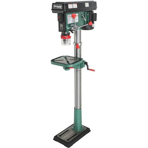

This 14" Heavy-Duty Floor-Model Drill Press features a digital spindle travel readout and laser pin-point accuracy for quickly aligning the workpiece to the drill entry point.
  • Motor: 3/4 HP, 110V, single-phase, 9A
  • Swing: 14"
  • Drill chuck: 1/64"–5/8"
  • Drilling capacity: 3/4" steel
  • Spindle travel: 3-1/4"
  • Spindle taper: MT#2
  • Number of speeds: 12 (140, 260, 320, 380, 480, 540, 980, 1160, 1510, 1650, 2180, and 3050 RPM)
  • Quill flange/collar dia: 2.595"
  • Precision-ground cast iron table
  • Table size: 11-3/8" x 11-3/8"
  • Table swing: 360º
  • Table tilt: 90 degrees left and right
  • T-slot width: 5/8"
  • Footprint: 18" x 11"
  • Overall height: 64"
  • Approximate shipping weight: 171 lbs.
