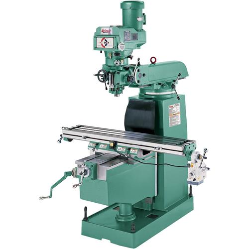

This is one of the largest capacity milling machines we have. With an incredible 10" x 54" table, huge table travel and 3 HP 3 Phase motor, just about any job can be done. And these castings are massive! Made to exacting specifications, this milling machine will give repeatable results in close tolerance work. This machine will give excellent results and years of reliable performance. Please check out the features and specifications below. It will be impossible to find a comparable value.
  • Spindle travel: 5"
  • Table size: 10" x 54"
  • Table travel (longitudinal): 33-3/4"
  • Table travel (cross): 15-1/2"
  • Max. dist spindle to column: 24-1/2"
  • Max. dist. spindle to table: 17"
  • Knee travel: 16-3/4"
  • Head tilt: 45° both ways
  • Head swivel: 90° both ways
  • T-slots: 3 on 2-1/2" centers, 1/2" stud
  • Variable speed range: 60 - 4250 RPM
  • Motor size: 3 HP, 3 Phase
  • Voltage: 220V
  • RPM: 1720
  • Power Transfer: V-belt
  • Shipping weight approx.: 3677 lbs.
Features:
  • One-shot Pump Lubrication
  • Auto Down Feed
  • Quill Feeds / Spindle Rev.: 0.0019", 0.0035", 0.0058"
  • Auto Shop w/ Micro Adjustable Stop
  • R-8 Spindle
  • Longitudinal Power Feed
  • Hardened & Ground Table Surface
  • Chrome Plated, Precision Ground Quill
  • Adjustable Micrometer Quill Depth Stop
