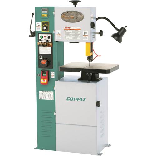

This versatile bandsaw allows intricate cutting of aluminum or brass to tool steel. Features a blade welding station which includes a cutter, welder, annealer and a grinder. Ideal for making inside cuts and quick repairs.
Features:
  • Variable speed from 104–1300 FPM
  • Blade welding station includes cutter, welder, annealer and grinder
  • Left, right table tilting control
  • Integrated chip pan
  • Upper and lower blade guides
  • Work light
  • Wheel brush
  • Main motor: 1 HP, 220V, 3-phase, 1725 RPM with single-phase inverter
  • Grinder motor: 1/8 HP, 220V, single-phase
  • Power source: 220V, single-phase, 60 Hz
  • Maximum cutting height: 5-1/8"
  • Throat capacity: 12-3/16"
  • Blade length range: 94-1/4"–98-1/4"
  • Blade size range: 1/8"–3/8"
  • Included blade size: 97" x 1/4" x 14 TPI (similar to Grizzly model G8804)
  • Blade speed: Variable, 104–1300 FPM
  • Electric welder: 1.2 KVA
  • Table tilt: 45° right, 15° left
  • Floor to table height: 34-5/8"
  • Table size: 18-1/8" x 22-1/8"
  • Overall dimensions: 34" W x 59-7/8" H x 21-1/4" D
  • Approximate shipping weight: 566 lbs.
