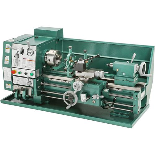

This metal lathe is an incredible value. Produced with precision slides and ways, the G4002 will keep up with the most demanding machining job!
Features:
  • Removable gap bed allows turnings up to 17" in diameter
  • Nine spindle speeds - ranging from 70 to 1400 RPM
  • Easy-to-use lever controls
  • Hardened and ground cast iron bed
  • Cuts 4-112 Standard TPI and 0.2-4.5 Metric
  • Full length splash guard
  • On/off/reverse switch on carriage
Standard Equipment:
  • 6" 3-Jaw chuck w/2 sets of jaws
  • 8" 4-Jaw chuck w/reversible jaws
  • 10" Faceplate
  • Steady rest
  • Follow rest
  • Quick-change tool post w/holder
  • 4-Piece insert tool holder set
  • Set of seven change gears
  • Dead center MT#3 HSS tip
  • Dead center MT#3 carbide tip
  • Live center MT#3
  • 1/2" Drill chuck w/MT#3 arbor
  • Spindle sleeve MT#5/MT#3
  • Oil can
  • Toolbox
  • Swing over bed: 12"
  • Swing over gap: 17"
  • Swing over cross slide: 7"
  • Distance between centers: 24"
  • Bed width: 7-1/4"
  • Spindle bore: 1.417" (36mm)
  • Taper of spindle bore: MT#5
  • Spindle: Camlock D1-4
  • Cross slide travel: 6-1/4"
  • Cuts LH threads
  • Compound travel: 3-1/4"
  • Tailstock barrel taper: MT#3
  • Tailstock barrel travel: 4"
  • Diameter of tailstock barrel: 1-9/16"
  • Number of speeds: 9
  • Range of speeds: 70, 200, 220, 270, 360, 600, 800, 1000, 1400 RPM
  • Motor: 2 HP, single-phase, 220 Volt, 8.5 amps, 60 Hz, 1725 RPM
  • Height w/o stand: 23"
  • Height w/ stand: 52"
  • Length w/ stand: 53"
  • Width of stand: 26"
  • Approx. shipping weight: 1004 lbs.
