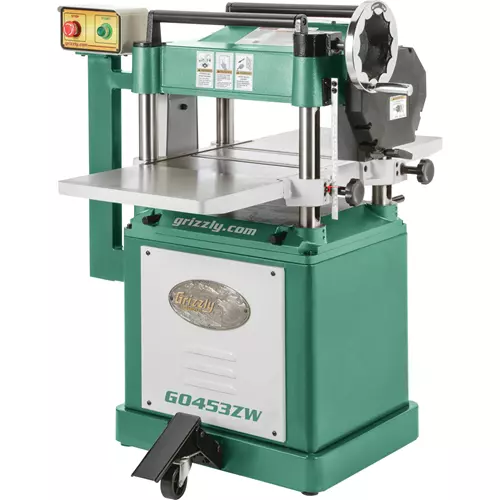

We've taken the best all around 15" planer and added a 4-row spiral cutterhead with German indexable carbide inserts for the finest surface finishes money can buy. Just like the model G0453W, you'll also appreciate the built-in mobile base, adjustable bed rollers, two-speed automatic board feed, and solid cast iron extension wings. We've also upgraded the magnetic switch control to a solid pedestal-mounted switch arm. If you're looking for a great all around 15" planer, this is the one to own!
  • Motor: 3HP, 240V, single-phase, 12A
  • Maximum cutting width: 15"
  • Maximum stock thickness: 8"
  • Minimum stock thickness: 3/8"
  • Minimum stock length: 6-1/2"
  • Maximum cutting depth: 1/8"
  • Feed rate: 16 & 20 FPM
  • Cutterhead diameter: 3"
  • Number of indexable carbide inserts: 72
  • Insert size: 14 x 14 x 2mm
  • Cutterhead speed: 5000 RPM
  • Solid serrated steel infeed roller
  • Table size: 41-3/4" x 16"
  • Overall size: 38"W x 42"D x 44"H
  • Approximate shipping weight: 602 lb.
Features:
  • Spiral cutterhead with German-made indexable carbide inserts
  • Built-in mobile base
  • Board return rollers
  • Adjustable bed rollers
  • Four-column support with table locks
  • 4" dust port
  • Precision-ground cast iron table and wings
  • Heavy-duty cast iron construction
