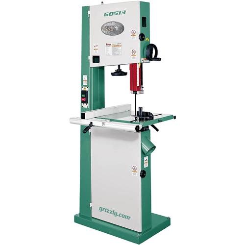

For those that need a respectable cutting capacity at a respectable price, Grizzly is proud to offer this full-featured 17" Heavy-duty Bandsaw. The 2 HP motor powers through wood up to a maximum 12" cutting capacity, and the 16-1/4" throat offers lots of room to move. Features like the deluxe fence, heavy-duty miter gauge, dual 4" dust ports, micro-adjusting geared table, and European-style blade guides are usually found on machines costing much more. And, the ISO 9001 factory designation assures high-quality standards. Also CSA certified meeting CSA C22.2 #71.2-10 and UL 987-8 standards!
  • Motor: 2 HP, 110V/220V, single-phase, TEFC capacitor start induction, 1725 RPM, 60 Hz, prewired 220V
  • Amps: 19A at 110V, 9.5A at 220V
  • Table size: 17" x 17" x 1-1/2" thick
  • Table tilt: 10° left, 45° right
  • Floor to table height: 37-1/2"
  • Cutting capacity/throat: 16-1/4" left of blade
  • Maximum cutting height: 12-1/8"
  • Blade size: 131-1/2" long
  • Blade width range: 1/8" - 1" wide
  • 2 blade speeds: 1700 and 3500 FPM
  • Wheels: Computer-balanced cast-aluminum with polyurethane tires
  • Wheel covers: Pre-formed steel
  • Euro-style roller-disc blade guides with full enclosure protection
  • Sealed and permanently lubricated bearings
  • Overall size: 73" H x 32" W x 32" D
  • Footprint: 27" L x 17-3/4" D x 2-1/2" H
  • Approximate shipping weight: 342 lbs.
  • Deluxe extruded-aluminum fence
  • Includes miter gauge
  • Two 4" dust ports
  • Quick-change blade release/tensioner
  • Blade tension indicator
  • Micro-adjusting geared table
  • Blade height measurement scale
  • Blade tracking window
  • Includes 1/2" 6-TPI hook blade
