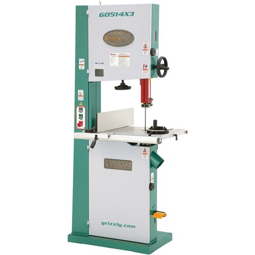

We've taken our ever popular and highly regarded G0514 and made another Extreme Machine. Cast iron wheels, double row ball bearing blade guides and a 3 HP motor help make this a wood devouring saw. The extra large tilting table and Grizzly patent pending Re-saw Fence make controlling the cut easy. You'll really appreciate the extra features like two 4" dust ports, a tracking window, quick release blade tension and tension scale. Both blade guide height and table tilt is handwheel controlled and the wheel covers are hinged for convenience. All this at a price nobody but Grizzly can offer! CSA certified meeting CSA C22.2 #71.2-08, CSA C22.2 #105-1953, and UL 987-7th standards!
  • Motor: 3 HP, 220V/440V*, 10A/5A, 3-phase, TEFC induction, 60 Hz, prewired 220V
  • RPM: 1725
  • Precision-ground cast iron table
  • Table size: 26-3/4" x 19" x 1-1/2" thick
  • Floor to table height: 37-1/2"
  • Cutting capacity/throat: 18 1/4"
  • Maximum cutting height: 12"
  • Blade size: 143" long
  • Blade sizes available: 1/8" - 1-1/4"
  • 2 Blade speeds: 1700, 3500 FPM
  • Wheels: fully balanced cast iron with polyurethane tires
  • Wheel covers: pre-formed, hinged steel
  • Blade guides: dual ball bearing with full enclosure protection
  • Bearings: sealed and permanently lubricated
  • Overall size: 76" H x 36" W x 32" D
  • Approximate shipping weight: 456 lbs.
Features:
  • Blade tension indicator
  • Micro-adjusting gear table
  • Height scale measurement
  • Fence with scale and magnifying window
  • Deluxe cast iron fence with extruded aluminum re-saw fence
  • Miter gauge
  • 4" dust port x 2
  • Table tilt: 10° left, 45° Right
  • Quick-change blade release/tensioning
  • Rack and pinion upper guide adjustment
  • Includes 3/4" 6-TPI blade
440V operation requires purchasing additional components and installation by our technicians. Please call customer service at (570) 546-9663 for more information.
G440VG0514X3 440V conversion kit required for those wanting to use this saw on 440V power!
