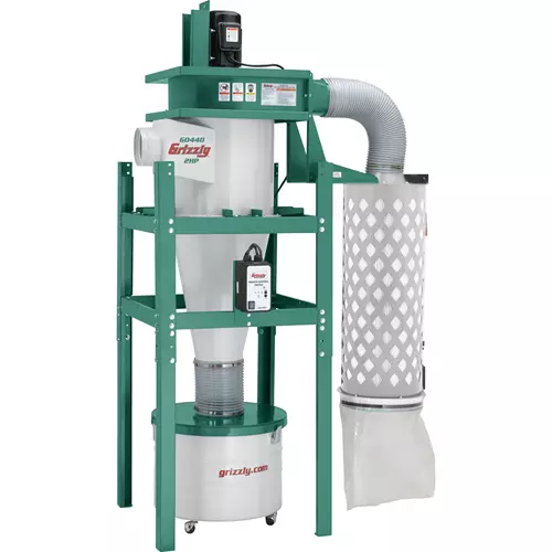

Cyclonic action separates the heavy dust particles from the fine particles and drops them into the 35-gallon steel drum. The fine dust travels past the 14-1/2" diameter impeller and is then trapped by a cartridge filter made of spun-bond polyester that filters 99.9% of particles from 0.2 to 2 microns in size. The cartridge filter is pleated to provide 96 square feet of surface area for efficient air movement and a clear plastic bag collects the fine cake that shakes off the filter for consistent dust collector performance. Casters mounted to the drum also make disposal of the larger chips and dust as easy as it gets. Other features include: a vertical motor support for reduced vibration, thick walled 11GA steel blower housing, 16GA steel cyclone body, 360° blower rotation for easy connection to a duct system, TEFC Class "F" motor, magnetic switch, and a remote control. The optional steel legs and support frame (H7499) also make setup quick and easy.
CSA certified meeting CAN/CSA C22.2 #243-10 and ANSI/UL 1017-8 standards!
  • Motor: TEFC Class “F”, 2 HP, 220V, single-phase, 3450 RPM, 14A
  • Switch: Remote controlled magnetic
  • Intake hole size: 7"
  • Impeller size: 14-1/2" steel radial fin
  • Suction capacity: 1354 CFM @ 2.5" SP
  • Maximum static pressure (inches of water): 10.4"
  • Filter surface area: 96 sq. ft.
  • Sound rating: 83–85 dB
  • Filter: 99.9% efficiency captures 0.2–2 micron dust particles
  • Collection drum: Steel, 35 gallons
  • Overall dimensions: 59" W x 93-1/2" H x 38" D
  • Approximate shipping weight: 352 lbs.
    Shown with H7499 optional stand
