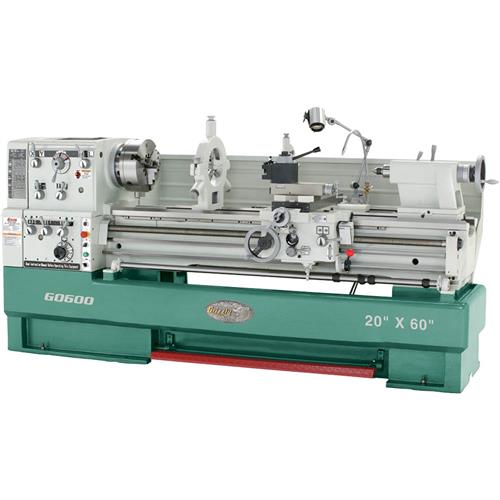

Once again, you asked and Grizzly delivered! This heavy-duty gear-head lathe with a large, 3-1/8" spindle bore is the latest addition to our fine selection of metal lathes. Its massive size and full capacities will allow you to chuck-up any heavy work piece with confidence. Whether you need to turn stainless, brass or large castings, its 13-3/4" wide bed, heavy-duty tailstock, excellent speed range, coolant pump and powerful 10 HP motor will give you the best possible finishes. What's more, it comes supplied with an auto apron stop so you can preset up to 4 different shoulders along the length of your shafting. With a quick change tool post, steady & follow rest and hex drive feed rod for smooth, consistent motion, you have the flexibility needed to tackle any job quickly. Check out the features and standard equipment list below!
Features:
  • Hardened and precision-ground Meehanite bed casting
  • Universal quick change gear box for inch, metric, modular, and diametral pitches
  • Hardened and precision-ground headstock, quick change and apron gears run in an oil bath
  • Adjustable apron clutch
Standard Equipment:
  • 12" 3-Jaw scroll chuck
  • 14" 4-Jaw independent chuck
  • 17-3/4" faceplate
  • Thread dial
  • One-shot lubrication on apron
  • 4-position auto apron stop
  • Full length splash guard
  • Dual inch/metric dials
  • Quick change tool post and holder
  • Jog & emergency stop button
  • Foot brake
  • #5–#7 Morse taper sleeve
  • Centers, service tools, tool box, leveling pads and manual
  • Steady rest
  • Follow rest
  • Coolant system
  • Halogen worklight
  • Motor: 10 HP, 220V, 3-phase
  • Swing over bed: 20"
  • Swing over gap: 29"
  • Swing over saddle: 12"
  • Distance between centers: 60"
  • Spindle nose: D1-8 camlock
  • Spindle nose taper: MT#7
  • Spindle bore: 3-1/8"
  • Tailstock barrel taper: MT#5
  • Tailstock barrel travel: 7"
  • Cross slide travel: 12-3/4"
  • Compound travel: 5"
  • Number of speeds: 12
  • Speed range: 25-1600 RPM
  • Range of threads (inches): 60 @ 2-112 TPI
  • Range of threads (metric): 47 @ 0.2-14 mm
  • Cuts LH threads
  • Diametrical pitch range: 50 @ 4-112 DP
  • Modular pitch range: 39 @ 0.1-7 MP
  • Width of bed: 13-3/4"
  • Approximate shipping weight: 5758 lbs.
