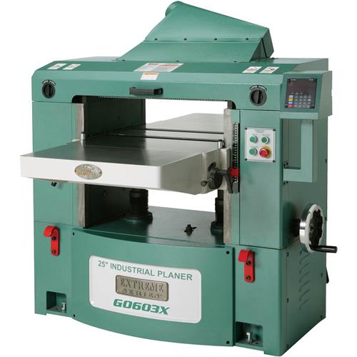

Our G0603X has an incredible 15 HP motor to make quick work of those big planing jobs. It also features a unique spiral cutterhead with 15° rotated inserts for smooth shearing cuts—meaning you can say goodbye to tear-out—while having an ultra quiet machine and a smoother finish. We’ve even added digital controls to allow you to simply enter the thickness of the board you want or the amount you want to remove, which saves time and reduces waste. All controls are conveniently located. And because it’s a Grizzly Extreme Series®, you can be assured of years of trouble-free service.
Features:
  • Segmented chip breaker
  • 5" dust port
  • Micro-adjustable table height
  • Infeed roller is serrated steel
  • Outfeed roller is finely finished steel
  • Digitally controlled table elevation for extreme accuracy
  • Adjustable bed rollers
  • Easy access cutterhead
  • 3-Speed (20,25,30) feed Rate
  • Inch/metric readout
  • Emergency stop button
  • Cutterhead motor: 15 HP, 230V/460V*, 3-phase, 37A/18.5A
  • Table elevation motor: 1/2 HP, TEFC, 2.4A/1.2A
  • Table size: 25" x 57"
  • Maximum cutting width: 25"
  • Maximum stock thickness: 9"
  • Maximum cutting depth: 1/4"
  • Minimum stock thickness: 1/4"
  • Minimum stock length: 10"
  • Feed rate: 20, 25 & 30 FPM
  • Cutterhead: 6 spirals, 170 inserts
  • Cutterhead speed: 4900 RPM
  • Power transfer: Triple V-belt
  • Overall size with infeed/outfeed tables: 60-1/4"H x 57-3/8"W x 54-3/8"D
  • Approximate shipping weight: 2054 lbs.
    *460V operation requires purchasing additional components and installation by our technicians. Please call customer service at (570) 546-9663 for more information

    Impressive machine 9/21/2016
    Much heavier duty than most small shops need, but this is an impressive planer. We've had it for a couple of weeks now. Heavy, solid. Appears extremely well built. When planing panels, you can barely hear it over the dust collector and other shop noise. We use it to plane down glued up panels for cabinet doors, we flatten one side of panel before shaping the panel cove/ogee/whatever. We also use it to take panels down to 5/8" or 3/8" as needed, leaving 1/16" over for the wide-belt. With bottom rollers set flush with the table, there is some planer snipe you can feel with your hand, but the calipers show only about .005" variation from thickest to thinnest on any of the panels, this is completely acceptable for a planer to be honest.
    Was easy to set up. We used a torque wrench to test the tightness of all the cutters, found no problems there, just being cautious. Had grizzly install the 440V option for us. Easy to use, we just punch in the desired thickness, hit enter then go (or something simple like that) and table goes slightly past the number, then goes to the exact number you set. I'm sure going past the number is to get the slack out of the mechanism so the table doesn't drop on you while planing.
    We have good dust suction, and there is virtually no chips being thrown out of the machine while operating.
    Quiet, clean, hopefully reliable. 10/10 would buy again.
