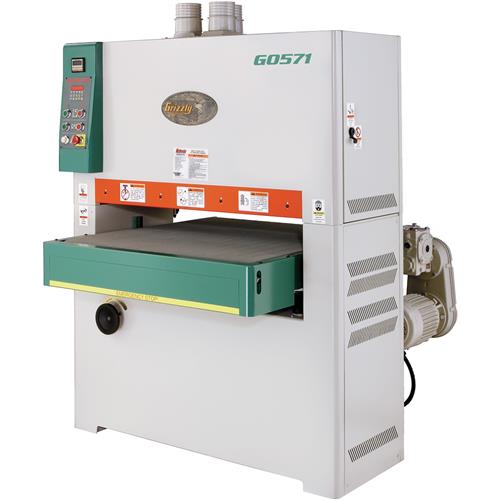

We sell more wide-belt sanders than just about any company in the USA! Filling in the gap between the popular 25" and 43" wide-belt sanders, our 37" Wide-Belt Sanders offer professional sanding results, unmatched accuracy, and unbeatable value. State-of-the-art digital controls, a micro-adjustable graphite/felt platen and three super efficient dust collection ports are just a few features that make these sanders a joy to use. If you are looking for the best that money can buy, Grizzly Wide-Belt Sanders have been designed and priced just for you! CSA certified meeting CSA C22.2 #105-1953 and UL 987-7th standards.
Features:
  • Built in air filter/lubricator
  • Independent motor control
  • Pneumatic belt tracking and tensioning
  • Amp meter for load measurement
  • Safety shut-off bar
  • Digital readout and control panel
  • (3) 4" dust ports
  • Steel cabinet
  • Rubber infeed drum
  • Steel outfeed drum
  • Rubber pressure drums
  • Micro-adjustable graphite/felt platen
  • Type: Platen
  • Sanding motor HP: 10 HP
  • Sanding motor voltage: 220V
  • Sanding motor phase: single-phase
  • Sanding motor amps: 50A
  • Conveyor motor HP: 1 HP
  • Conveyor motor amps: 7A
  • Table lift motor HP: 1/3 HP
  • Table lift motor amps: 3A
  • Footprint: 19" x 51-1/2"
  • Maximum board width: 36-1/2
  • Maximum board thickness: 6"
  • Minimum board length: 14"
  • Minimum board thickness: 1/8"
  • Front drum surface speed: 2600 FPM
  • Conveyor speed: 15–49 FPM
  • Air requirement: 57 – 75 PSI, 7 CFM
  • Sanding belt size: 37" W x 60"
  • Overall width: 53"
  • Overall height: 69-1/2"
  • Overall depth: 49-1/2"
  • Approx. shipping weight: 1818 lbs.
