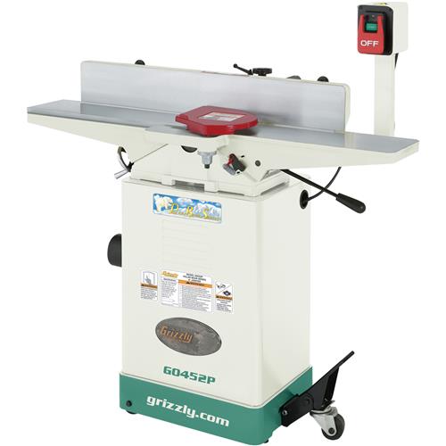

Our best selling 6" Jointer is now available in our beautiful white Polar Bear Series color scheme. You still get the same heavy cast iron infeed and outfeed tables that slide on adjustable dovetailed ways, center-mounted fence with rack and pinion lateral control and a solid, one-piece cabinet stand with a built-in mobile base. Pound for pound, you won’t find a better 6" Jointer around (unless of course, it’s our G0452)! CSA certified meeting CSA-C22.2 #71.2-10 and UL 987-8th standards!
  • Top-mounted switch control
  • Center-mounted fence
  • Rack and pinion fence adjustment
  • Positive fence stops
  • Rabbeting table
  • Solid one-piece cabinet stand
  • Built-in mobile base
  • 4" dust port
  • Infeed table has lever control for convenient table height adjustment
  • Motor: 1 HP, 120V, single-phase, 13 Amp
  • Maximum stock width: 6"
  • Maximum depth of cut: 1/8"
  • Maximum rabbeting capacity: 1/2"
  • Cutterhead diameter: 2-1/2"
  • Number of knives: 3 HSS
  • Knife size: 6" x 5/8" x 1/8"
  • Cutterhead speed: 4800 RPM
  • Table size: 7-1/2" x 46"
  • Table height from floor: 32-1/2"
  • Cuts per minute: 14,400
  • Fence size: 5" high x 35" long
  • Fence adjustment: positive stops @ ± 45° & 90°
  • Overall dimensions: 46" long x 27-1/2" wide x 49" high
  • Approximate shipping weight: 266 lbs.
  • Free pair of safety push blocks
