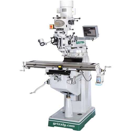

G0796 9" x 49" 3 HP Vertical Mill with Power Feed and DRO
Amazing features at an affordable price.
The G0796 9" x 49" Vertical Mill with power feed and DRO is a full featured mill built for those that only have single-phase power. This machine has a 2-axis DRO to ensure exact table position at all times.
With the 9" x 49" table, you can set up a rotary table or another fixture on one side without having to remove your vise on the other. Additionally, the table has a built-in longitudinal power feed!
The bed of the lathe is constructed with Meehanite® castings that are hardened and precision-ground in the traditional three V-way prismatic design.
The one-shot pump action lubricates the X-, Y- and Z-axis table ways. The halogen work light provides direct light on your workpiece for improved visibility.
Like all Grizzly vertical milling machines, the G0796 comes with a 1-year warranty which covers parts and assures the unit is free from factory defects.
The G0796 manual was written by our U.S.-based Technical Documentation Department and is packed with useful information. The complete and easy-to-read manual makes it easier to assemble and maintain your mill.
The Grizzly Customer Service and Technical Support Teams are U.S.-based. Parts for the mill are available online and shipped from the Grizzly parts warehouse in Springfield, MO.
