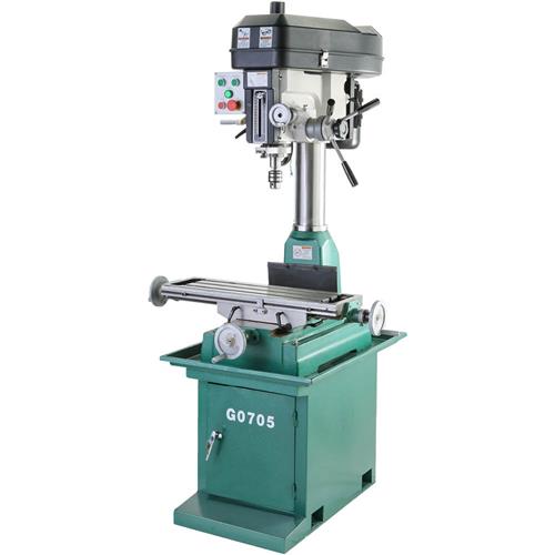

This heavy-duty Mill/Drill has a 2 HP motor and enough table space to make quick work of just about any machining job you can throw at it. Priced so competitively compared to other brands, you can use the savings for the G1076 Clamping Kit or even our G7155 6" machining vise! Of course, with the R-8 spindle, tooling up is a snap and with the cabinet in the stand, you'll have the convenience of storing everything right where you need it most!
Features:
  • Fine down feed is engaged by clutch-type mechanism
  • Easy-to-use depth stop
  • Heavy-duty, 12-speed tapered roller bearing spindle
  • Forward/Reversing switch with emergency stop
  • Stand with chip tray and cabinet
  • Coolant trough
  • Motor: 2 HP, 110V/220V, single-phase
  • Spindle taper: R-8
  • Spindle travel: 4-11/16"
  • Swing: 15-1/2"
  • Max. distance spindle to table: 17-5/16"
  • Column size: 4-1/2"
  • Collars graduated: 0.001"
  • T-Slots: 3 @ 2-1/2" centers, 5/8" wide
  • Table size: 8-1/4" x 28-3/4"
  • Table travel (longitudinal): 19-11/16"
  • Table travel (cross): 7-1/2"
  • Drilling capacity: 1-3/16" for cast iron, 1" for steel
  • Number of speeds: 12
  • Range of speeds: 140, 219, 263, 317, 413, 475, 819, 1075, 1238, 1450, 1770, 2436 RPM
  • Approximate shipping weight: 750 lbs.
