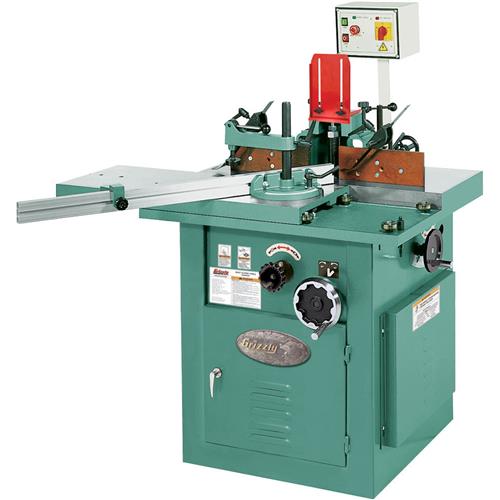

We've taken our immensely popular G5912Z Shaper and made it even better with a sliding table and tilting spindle! Now, even the most complicated profiles can be made quickly, consistently and safely on all sides and sizes of workpiece.
  • Motor: 5 HP, 220V, single phase
  • Spindle travel: 3-1/4"
  • Spindle tilt: 45 degrees
  • Spindle size: 3/4", 1" and 1-1/4"
  • Spindle capacity: 5-1/8" (1-1/4" spindle)
  • Spindle speeds: 3600, 5100, 8000 & 10,000 RPM
  • Maximum cutter diameter: 5-7/8"
  • Sliding table: 35-1/2" wide x 13-1/4" deep
  • Table travel: 21-7/8"
  • Table fence: 39-1/2" extruded aluminum with adjustable stop
  • Cast iron miter gauge with 60° angle capability in two directions
  • Lever actuated stock hold-down integral to the miter gauge
  • 4" dust port
  • Approximate shipping weight: 834 lbs.

im a man of few words, the fence sucks it sticks the mold is crooked and i bought a 1/2" plastic uhmw to flatten the fence . for this kind of money you think the fence could be ground flat.. on a another note... the shaper works well no drag on 1 1/2 oak doors
