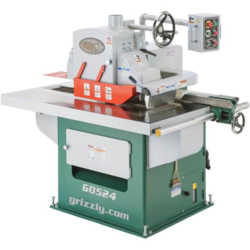

If your shop needs glue-line quality rip cuts, then Grizzly has the saw for you! Designed for the professional shop, the Grizzly G0524 Straight-Line Rip Saw features a variable feed speed of 30-112 FPM, a 53" x 37" precision-ground cast iron table, a 3-7/8" depth of cut capacity, a smooth action conveyor feed system, and an extra long table and rip fence for long boards. Power is supplied by a 15 HP main motor and a 2 HP feed motor. Feature-for-feature and dollar-for-dollar, there is no better saw on the market! Optional Laser Guide w/Arm (H5749) purchased separately.
Features:
  • Variable speed conveyor
  • Dual-bearing driveline for conveyor table
  • Exclusive 6" wide chain feeding conveyor table for smooth operation
  • Dual-spindle lock prevents spindle drop while running
  • Auto-lube system is adjustable for precise lube intervals
  • Main motor: 15 HP, 220V/440V*, 3-phase
  • Feed motor: 2 HP, 220V/440V*, 3-phase
  • Table size: 53" x 37"
  • Floor to table height: 32-1/4"
  • Maximum cutting thickness: 3-7/8"
  • Minimum cutting length: 8" (with included hold-down roller kit)
  • Feed speed (variable): 30–112 FPM
  • Saw blade diameter: 10"–12"
  • Maximum cutting width: 18"
  • Arbor diameter: 1"
  • Spindle speed: 4500 RPM
  • Dust port diameter: (1) 4"
  • Overall dimensions: 61-1/4" long x 43-1/2" wide x 80-1/2" high
  • Approximate shipping weight: 2243 lbs.
    440V operation requires purchasing additional components and installation by our technicians. Please call customer service at (570) 546-9663 for more information.
