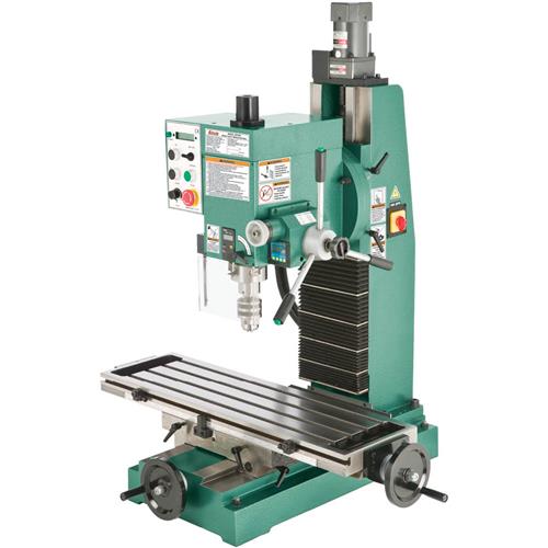

These benchtop mills have all the features you need to take on the most demanding projects. Start with the easy to use spindle speed control — just turn the dial to set your speed for optimum cuts and tool life. Tapping is also a breeze with the reversing switch control right in the handles. There are even digital displays for spindle speed, spindle height and head angle for excellent heads-up operation! And, don’t forget the dedicated headstock elevation motor — no more cranking here, just push a button to clear the tooling, change it out and push another button to drop it down to get back into the action!
  • Power head elevation
  • Digital head tilt angle display
  • Head and table travel on dovetailed ways
  • Includes B16 drill chuck
  • Dovetail column
  • Digital spindle scale reads metric or inches, zero set, on/off, graduated in 0.0005"t
  • Digital display for spindle RPM
  • Reversing buttons on the spindle handles for tapping
  • Coolant trough
  • Front-mounted fine-feed knob
  • Front-mounted E-stop button
  • See-through chip guard
  • Made in an ISO 9001 factory
  • Motor: 2 HP, 110V, single-phase
  • Power source: 110V
  • Universal spindle taper: R8
  • Spindle travel: 3-5/16"
  • Swing: 22-3/4"
  • Max. distance spindle to table: 15-3/4"
  • T-Slots: 4 @ 2-1/8" centers, 9/16" wide
  • Table size: 9-1/2" x 32-1/4"
  • Table travel (longitudinal): 17-5/8"
  • Table travel (cross): 9-5/8"
  • Headstock travel: 13-1/8"
  • Headstock tilt: 90° L, 45° R Drilling capacity: 1-1/8"
  • Quill diameter: 2.56"
  • Variable speed: 100-1600
  • Approximate shipping weight: 768 lbs.
