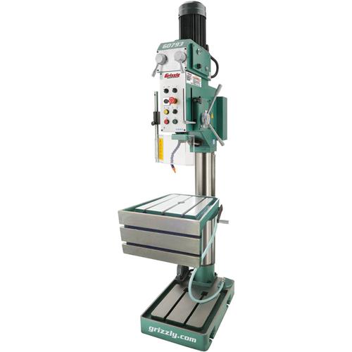

Standing 89-1/2" tall, weighing over 1000 lbs., and featuring a 27-1/2" swing, this Heavy-Duty Gearhead Drill Press is built for the most demanding jobs. The massive 6" diameter column provides the necessary rigidity to ensure repeatable accuracy -- even when drilling 1-1/2" diameter holes at high speeds! The MT#4 spindle has 7" of travel, 18 speeds from 60 - 1740 RPM, 2-speed automatic downfeed, power tapping with manual clutch, and a tooling ejection feature for fast bit changes. The cast iron table is nearly 2" thick and features a unique 22" x 19-1/16" L-shaped work surface, five 5/8" T-slots, and coolant drainage troughs. The maximum spindle-to-table distance is 30-3/4", and if that's not enough, the table rotates out of the way so that the workpiece can mount to the precision-ground base table using its two 5/8" T-slots. This colossal workhorse also includes a built-in coolant system to keep metal cool and drilling precise!
Features:
  • Front-mounted emergency stop button
  • See-through chip guard
  • Pump-driven coolant system
  • Standard and metric guide rulers
  • Solid cast iron construction
  • 360 degrees table positioning around column
  • Built-in halogen work light
  • Depth stop with auto shut-off switch
  • Spindle speeds change with convenient gearhead levers
  • Base has precision-ground work surface with two 5/8" T-slots
  • Main motor: 2 HP, 220V, 3-phase, 6.4A
  • Coolant pump: 60W, 220V, 3-phase, 0.2A
  • Max spindle-to-column distance: 13-1/2"
  • Max spindle-to-table distance: 30-3/4"
  • Spindle travel: 7"
  • Spindle taper: MT#4
  • Spindle speeds: 18 (60, 90, 120, 130, 150, 180, 215, 260, 300, 310, 415, 440, 600, 625, 830, 870, 1220, 1740 RPM)
  • Table size: 22" L x 19-1/16" W x 1-7/8" H
  • T-slot size: 5/8"
  • Vertical table travel: 20"
  • Table swivel: 360 degrees
  • Downfeed speeds: 1mm/rev., 2mm/rev.
  • Quill diameter: 3"
  • Column diameter: 6"
  • Footprint: 20" W x 29" D
  • Overall size: 22" W x 89-1/2" H x 37" D
  • Approximate shipping weight: 1202 lbs.
