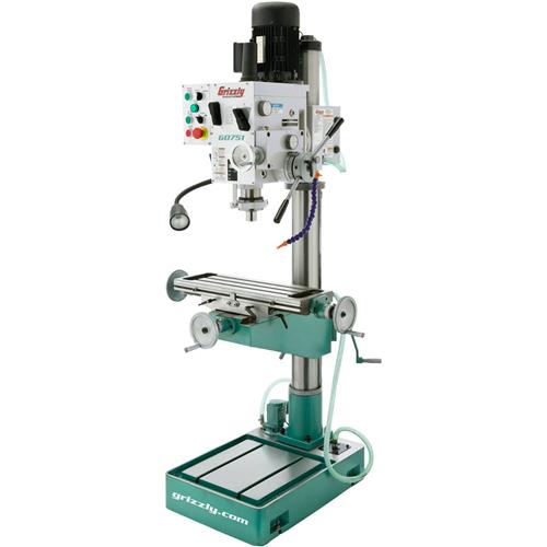

    Finally, there is a heavy duty drill press tough enough to withstand the rigors of daily, industrial use - yet still is versatile enough to tackle serious drilling, tapping, and even milling jobs with precision and ease! Features an X/Y-axis table on precision dovetail ways, multi-function digital spindle scale, high-precision P5 spindle bearings, 4-speed automatic quill feed, convenient gear-head spindle speed controls, adjustable halogen worklight, and built in coolant system. The head tilts 45° left or right, and both the head and table are mounted on separate rack-and-pinions, allowing them to rotate 360° and move up/down independently from each other - and allowing you plenty of "positioning freedom" when machining otherwise difficult to reach places. Additionally, the base is precision ground and equipped with 7/16" T-slots - just like the table - providing an extra work-holding surface. Made in an ISO 9001 factory!
    • Motor: 2 HP, 220V, single phase, 1725 RPM, 8.6A
    • Swing: 22"
    • Max. distance spindle to table: 24-3/8"
    • Max. distance spindle to column: 11"
    • Table size: 7-1/2" x 23-5/8"
    • Table travel (longitudinal): 14-1/2"
    • Table travel (cross): 7-1/2"
    • Head travel: 10-1/2"
    • Table swivel: 360°
    • Spindle travel: 4-3/4"
    • Spindle speeds: 90, 210, 345, 670, 1180, 1970 RPM
    • Spindle taper: R-8
    • Drawbar size: 7/16"-20
    • Drilling capacity for cast iron: 1-1/2"
    • Drilling capacity for steel: 1-1/4"
    • Face mill capacity: 3"
    • End mill capacity: 1-1/4"
    • Head tilt left and right: 45° L, 45° R
    • Quill feed rates: 0.004, 0.007, 0.010 in/rev
    • Table T-slots: 3 at 2" centers, 7/16" wide
    • Overall dimensions: 29-1/2"W x 69-1/4"H x 36-1/2"D
    • Footprint: 19"W x 27"D
    • Approximate shipping weight: 849 lbs.
