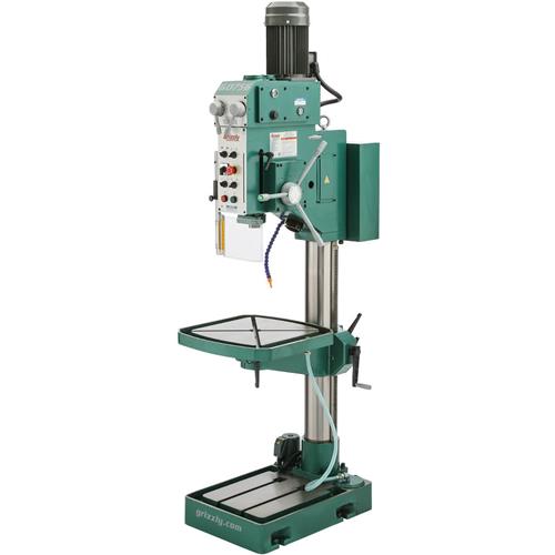

Standing 89-1/2" tall, weighing over 1000 pounds, and featuring a 27-1/2" swing, this Industrial-Duty Gearhead Drill Press is built for the most demanding production shops. The massive 6" column diameter provides the necessary rigidity to ensure repeatable accuracy—even when drilling 1-1/2" holes at high speeds! The MT #4 spindle has 7" of travel, 18 speeds from 60–1740 RPM, 2-speed automatic downfeed, power tapping with electronic clutch, and a tooling ejection feature for fast bit changes. The precision-ground cast iron table is nearly 2" thick and features a 22" x 22" work surface, two 9/16" crossed T-slots, and coolant drainage troughs. The maximum spindle to table distance is 30-3/4", and if that's not enough, the table rotates out of the way, so the workpiece can mount to the precision-ground base table, using its two 9/16" parallel T-slots. This colossal workhorse also includes a built-in coolant system, halogen worklight, and a toolbox packed full of goodies, such as an MT #4–MT #3 spindle adapter, MT #4–MT #2 spindle adapter, and 1/8"–5/8" drill chuck with arbor.
  • Main motor: 2 HP, 220V, 3-phase, 6.4A
  • Coolant pump: 60W
  • Swing: 27-1/2"
  • Max spindle to table distance: 30-3/4"
  • Spindle travel: 7"
  • Spindle size: MT #4
  • Spindle speeds: 18 (60, 90, 120, 130, 150, 180, 215, 260, 300, 310, 415, 440, 600, 625, 830, 870, 1220, 1740 RPM)
  • Downfeed speeds: 1mm/rev, 2mm/rev
  • Table size: 22" L x 22" W x 1-7/8" H
  • T-slot size: 9/16"
  • Vertical table travel: 20"
  • Table swivel: 360°
  • Max drilling capacity in cast iron: 1-1/2"
  • Max drilling capacity in steel: 1"
  • Quill diameter: 3"
  • Column diameter: 6"
  • Footprint: 20" W x 29" D
  • Overall size: 22" W x 89-1/2" H x 37" D
  • Approximate shipping weight: 1202 lbs.
Features:
  • Front-mounted emergency stop button
  • See-through chip guard
  • Pump-driven coolant system
  • Standard and metric guide rulers
  • Solid cast iron construction
  • 360° table positioning around column
  • Built-in halogen work light
  • Depth stop with auto shut-off switch
  • Spindle speeds change with convenient gearhead levers
  • Base has precision-ground work surface with two 9/16" T-slots
  • Spindle adapter sleeves included for MT #3 and MT #2 tooling
  • 1/8"–5/8" drill chuck with arbor
