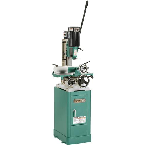

The flexibility to perform compound angles mortises with perfect control sets this Heavy-Duty Mortiser apart from all others. With a +/- 30° tilting head and 30° fence swing, just about any angle combination is possible. Other features include table longitudinal and cross slide travel, vertical and longitudinal stops, a 1 ½ HP motor and solid cast iron construction. Accepts standard mortising chisels with ¾” and 1 1/8” collars.
  • Motor: 1-1/2 HP, 110V/220V, single-phase, TEFC, 1725 RPM, prewired 110V
  • Amps: 14 / 7
  • Table size: 19" x 12-1/2"
  • Vertical spindle travel: 9"
  • Head vertical travel: 3"
  • Table longitudinal travel: 14-1/2"
  • Table cross travel: 3"
  • Column tilt: + or - 30°
  • Fence angle: 0 - 30°
  • Chisel capacity: 1/4" - 1-1/2"
  • Maximum chisel stroke: 6-1/4"
  • Maximum workplace width: 9"
  • Chuck capacity: 1/2"
  • Collar size: 5/8" and 3/4"
  • Spindle speed: 1725 RPM
  • Overall size: 71"H X 36"W X 24"D
  • Approximate shipping wt: 315 lbs
Features:
  • Solid cast iron construction
  • Dovetail ways on column
  • Rack and pinion headstock control
  • Air spring assisted head return
  • Work stop with extension rods for setting each workpiece exactly the same
  • Quick acting rack and pinion drive on longitudinal slide speeds up production of wide mortises
  • Tilting column
  • Angled fence adjustment
  • Large hold down clamp
  • Steel cabinet stand with indexed storage shelf for mortising chisels
