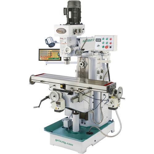

G0827 11" x 50" 2 HP Horizontal/Vertical Mill with DRO
Looking for unwavering torque and consistency in a solid gearhead mill?
This is it as it combines all the range of speeds you need with the size and features that any metalworking shop would want.
A milling machine with horizontal and vertical spindles performs a wide range of machining tasks without the need for extensive setup changes.
It features 8 vertical spindle speeds from 140–2100 RPM and 12 horizontal spindle speeds from 48–1560 RPM.
The head is mounted on a wide-dovetail movable ram with 18" of travel and can tilt 45° left to right. The turret has 180° rotating capability. The turret has 180° of swivel.
A Fagor 3-axis digital readout (DRO) reads down to a 0.0002" resolution for repeatable, accurate milling operations.
The G0827 features 3-axis table movement with independent longitudinal and horizontal power feeds. With the 11" x 50" table, you can set up a rotary table or another fixture on one side without having to remove your vise on the other!
And finally, this milling machine comes with a circulating coolant system with the pump and reservoir in the column base.
