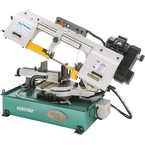

This full featured Metal-Cutting Bandsaw includes large cutting capacity, a swivel base to cut miters from -45 degrees to +60 degrees, variable speed control, hydraulic feed control and built-in coolant system. If you're looking for something in this size range, you'll have a tough time finding a better metal-cutting band saw with these features and at this price anywhere else. Metalworking production shops should take a good look at this!
Features:
  • Swivel base with degree scale
  • Centralized control panel on top of saw bow
  • Heavy-duty all steel, one piece base
  • Adjustable hydraulic down feed (just dial your feed rate)
  • Variable speed control
  • Quick positioning vise
  • -45 degree to +60 degree swivel
  • Tooth selection chart
  • Built-in coolant system
  • Automatic shut off
  • Adjustable blade guide system
  • Blade wheels have heavy-duty ball bearings
  • Adjustable head weight pressure
  • Wash down hose and spray gun
  • Adjustable positive stops for head angle
  • Motor: 2 HP, 220V, single phase, 1725 RPM
  • Blade size: 132" x 1"
  • Blade speeds: Variable, 98-394 FPM
  • Miter cutting capacity: -45 degree to +60 degree
  • Floor to table height: 20"
  • Overall dimensions: 72-1/2"W x 32"D x 42-1/2"H
Cutting capacities:
  • 90 degree, round: 10"
  • 90 degree, rectangular: 9-1/2" x 18"
  • +/- 45 degree, round: 10"
  • +/- 45 degree, rectangular: 10" x 11"
  • +60 degree, round: 8"
  • +60 degree, rectangular: 5" x 8"
  • Approximate shipping weight: 967 lbs.
