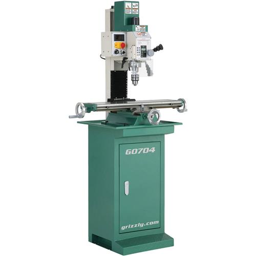

G0704 7" x 27" 1 HP Mill Drill with Stand
Grizzly's best-selling Mill Drill.
The G0704 7" x 27" 1 HP Mill Drill with Stand can be used as a dedicated, single-purpose machine in a professional shop. It can be easily operated by those just learning to mill in their home shop as well.
It is an excellent value and has some of the same features found on much larger mill drills. That’s why it is one of the best-selling mill drills in the country!
The variable-speed 1 HP motor powers the R-8 spindle from 50–1125 RPM in low and 100–2250 RPM in high. Spindle RPM can be monitored on the convenient digital readout. A clear chip guard on the spindle keeps debris from flying at the operator.
The large 7-1/16" by 26-5/8" table can be moved by handwheels in both the longitudinal and cross directions. Both feed directions can be locked by table lock levers.
The G0704 also features tapered gibs with double locks which adds accuracy and rigidity, a dovetail column; and it comes with its own stand.
