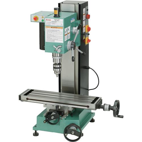

This rugged little brute is the cat's meow in small mill/drills. It has more features than even some of the large mill/drills starting with a dovetail column and variable speeds. And it comes with coolant troughs in the table, adjustable gibs in all the slides, a reversing switch, a standard 7/16"-20 TPI draw bar, R-8 spindle and easy to read dials with inch cut lead screws. With all these features and mass, you'll be able to mill, drill, bore and ream through the most serious hobby projects around!
Specifications
  • Motor size: 3/4 HP, 110V, single-phase, universal
  • Spindle taper: R-8
  • Spindle travel: 3 3/8"
  • Swing: 18"
  • Max. distance spindle to table: 14 3/4"
  • Collars calibrated: .001"
  • T-Slots: 3@ 1 11/16" centers, 3/8" studs
  • Table size: 6 1/4" x 21 5/8"
  • Table travel (longitudinal): 15 7/8"
  • Table travel (cross): 5 3/4"
  • Headstock travel: 14 7/8"
  • Drilling capacity: 1"
  • Quill diameter: 2.347"
  • Variable speed: 100-1000, 100-2000 (Hi-lo gearbox)
  • Approximate shipping weight: 372 lbs.
Features
  • Dovetail column with handwheel graduated in .0005"
  • Infinitely variable spindle speed from 0-4000 RPM
  • Push button emergency switch with indicator lights
  • Almost 14" of headstock movement
  • 2 speed gear box
  • Reversing switch
  • Coolant trough
  • Circuit fuse
  • Dial speed control
  • Dovetail column
  • Includes: 5/8" drill chuck and arbor, 2 T-nuts, 2 open end combo wrenches, 4 Allen® wrenches, extra drive belt, and 4 leveling feet.
