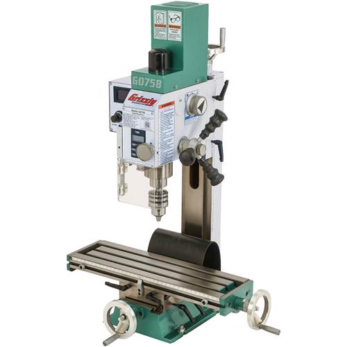

G0758 6" x 20" 3/4 HP Mill/Drill
With a high-torque but quiet motor, this versatile mill/drill is ready to be a key player in your shop.
Drawing from the heritage of producing previous mill/drills, the G0758 6" x 20" Mill/Drill comes packed with impressive features.
The 3/4 HP motor powers the variable-speed spindle control from 50 to 2000 RPM and is displayed on a DRO.
Tracking spindle depth is as easy as reading a separate DRO with inch/mm display and zeroing function.
Additionally it has super-rigid precision-ground dovetail headstock column and table ways, coarse and fine spindle downfeed, and precision handwheel control for X, Y, and Z-axis.
If that is not enough, this fiesty champ has one of the largest tables, table travel, and motor sizes in its class, allowing it to take on a huge range of workpiece sizes.
With its R-8 spindle taper, it can also make use of a wide variety of tooling.
The head is equipped with a special shifter knob that allows you to drop power-transfer gearing down for maximum torque in the lowest RPM range.
Shown with optional T26612 stand and chip tray.
Like all Grizzly Mills, the G0758 comes with a 1-year limited warranty.
The G0758 manual was written by our U.S.-based Technical Documentation Department and is packed with useful information. The complete and easy-to-read manual makes it easier to assemble and maintain your mill drill.
The Grizzly Customer Service and Technical Support Teams are also U.S.-based. Parts for the drill press may be available online and shipped from the Grizzly parts warehouse in Springfield, MO.
