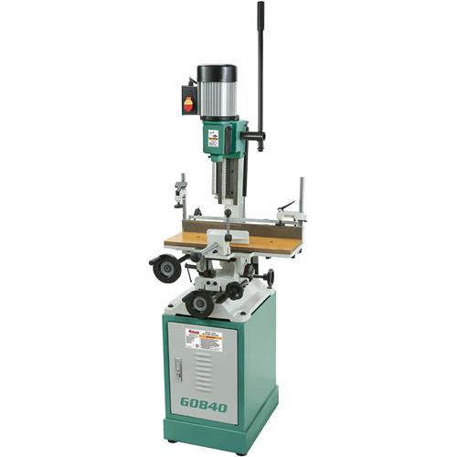

Introducing our G0840 Heavy-Duty Mortising Machine, featuring a unique rack-and-pinion controlled forward/backward tilting table, left/right tilting headstock, and handwheel controlled X/Y table, making it the perfect machine for those projects with hard to reach areas and tricky compound angles. With a 110V, 1 HP motor and chisel capacity of 1/4" to 1", this mortise is able to handle even the toughest jobs with ease. Equipped with a 21-1/4" x 7-1/2" table that has 11" of cross travel, 5-1/4" of longitudinal travel, and two large hold-down clamps to prevent unwanted movement. With its large capacity cast iron frame mounted on top of a sturdy steel cabinet, this mortise leads the way in its class and is sure to be a customer favorite!
  • Motor: 1 HP, 110V, single-phase, TEFC, 3580 RPM, 10.2A
  • Table size: 21-1/4" x 7-1/2"
  • Vertical spindle travel: 8-5/8"
  • Head vertical travel: 3"
  • Table longitudinal travel: 5-1/4"
  • Table cross travel: 11"
  • Column tilt left & right: ±20°
  • Table tilt front & back: ±22.5°
  • Chisel capacity: 1/4" - 1"
  • Maximum chisel stroke: 6-1/4"
  • Maximum workpiece width: 7-1/2"
  • Chuck capacity: 5/8"
  • Collar size: 3/4"
  • Spindle speed: 3580 RPM
  • Footprint: 19" x 15"
  • Overall size: 22"W x 30"L x 58"H
  • Approximate shipping weight: 295 lb.
Features:
  • Tilting table
  • X & Y moving table
  • Solid cast iron construction
  • Dovetail ways on column
  • Rack-and-pinion headstock control
  • Gas strut assisted head return
  • Adjustable work stops with two separate stop settings
  • Quick-change handle positioning for maximum leverage
  • Tilting column
  • Two large hold-down clamps
  • Steel cabinet stand with indexed storage shelf for mortising chisels
