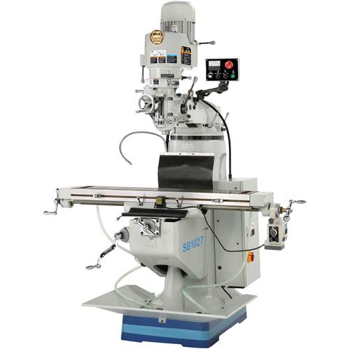

    CHIPMASTER® 406 EVS TURRET MILL with Digital RPM Display
    True to South Bend® fashion, this Electronic Speed Mill is made with uncompromising quality Hardened and ground table, chromed quill & Turcite coated ways mean built-in durability for years of service. With it's Yaskawa frequency drive, it only requires a single phase power source to provide variable speed control! Check out the capacities, features & specifications below! This is the machine to have for years of accurate, trouble-free operation. Beautiful South Bend® light gray & two-tone blue color scheme.
    Features:
  • Digital RPM display
  • Smooth, quiet operation
  • True electronic speed control
  • Standardized U.S. electrical components
  • Allen Bradley controls
  • Balanced polyvee belt design - class 7 spindle bearings
  • Table, knee & ram are equipped with dual locking mechanisms
  • Hand scraped surfaces & custom fit gibs guarantee alignment & accuracy
    Specifications
  • Table size: 9" x 48"
  • Workpiece capacity: 550 lbs.
  • Longitudinal travel (X-axis): 30"
  • Cross travel (Y-axis): 12"
  • Knee travel: 16"
  • Ram travel: 13"
  • Ram swivel: 360°
  • Max. distance spindle to table: 18"
  • Spindle taper: R-8
  • Quill diameter: 3.35"
  • Spindle speeds: Variable
  • EVS speed range: 50-575, 575-5000 RPM
  • Spindle feed: 0.0015" / 0.003" / 0.006"
  • Head tilt / head swivel: 45° / 90°
  • Turret diameter: 12.5"
  • Column graduations: .001"
  • Knee width: 11.625"
  • Knee to column bearing length: 16.5"
  • Motor: 3 HP, 220V, single phase input
  • Yaskawa 5 HP inverter
  • Power required: 25 amps / 15 KVA
  • Footprint: 72"L x 58"W
  • Net weight: 2,380 lbs.
  • Shipping weight: 2,675 lbs.
