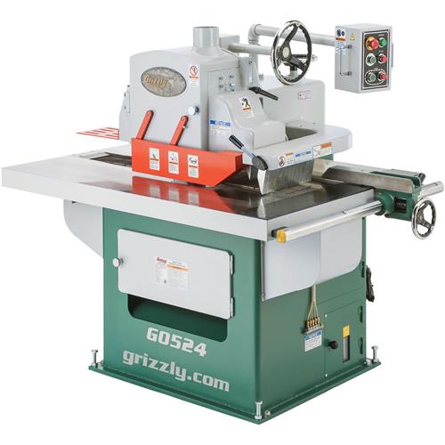

Description
If ripping is a regular cutting operation in your shop, then Grizzly has the saw for you! Designed for the professional shop, the Grizzly G0524 Straight Line Rip Saw features a variable feed speed of 52-92 FPM, a 51" x 37" precision ground cast iron table, a 4" depth of cut capacity, a smooth action conveyor feed system, and an extra-long table extension and rip fence for long boards. Power is supplied by a 15 HP main motor and a 2 HP feed motor. Feature for feature and dollar for dollar, there is no better saw on the market!
Features:
  • Variable speed pulley adjustment while the machine is running
  • Dual bearing driveline for conveyor table
  • Exclusive 6" wide chain feeding conveyor table for smooth operation
  • Dual spindle lock prevents spindle drop while running
  • Auto-lube system is adjustable for precise lube intervals
  • Extra-long infeed table and rip fence for handling large workpieces
  • Maximum cutting thickness: 4"
  • Minimum cutting length: 8" (with optional kit)
  • Feed speed (variable): 52-92 FPM
  • Max. saw blade diameter: 12"
  • Arbor diameter: 1"
  • Max. distance from blade to column: 14-3/4"
  • Spindle speed: 4100 RPM
  • Main motor: 15 HP, Three-phase
  • Feed motor: 1 HP
  • Dust port: (1) 4"
  • Table Size: 51" x 37"
  • Floor to table height: 33-1/2"
  • Pressure rollers: 4
  • Machine size: 53-3/16"L x 37-1/2"W x 54-3/8"H
  • Shipping size: 63"L x 45-1/4"W x 63"H
  • Shipping weight: 2535 lbs.
