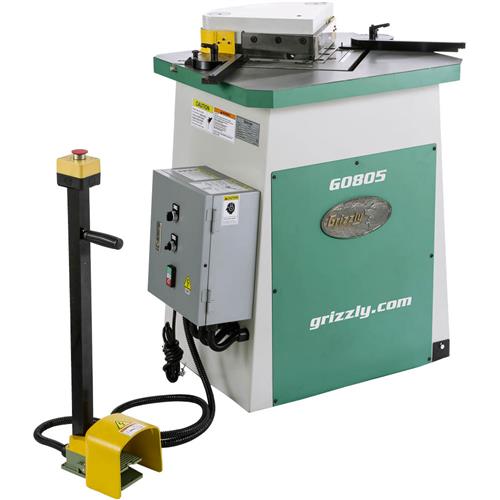

When it comes to powering through heavy-gauge sheet steel day-in and day-out, it's hard to beat the power and long-term durability of a hydraulic ram system. If power and durability are must-haves for your shop, look no further than our G0805 Super Heavy-Duty Angle Notcher for shearing consistent notches up to 7-7/8" x 7-7/8". Precision-ground hardened-steel blades slice at a blazing 50 stroke per minute thanks to the 3 HP direct-drive motor. Cutting operations are also a breeze with the independentlyadjustable fences and movable foot-control pedestal, which allows you to stand back and support large workpieces safely while still completing the cut.
  • Motor: 3 HP, 220V or 440V*, 3-phase, prewired for 220V
  • Amps: 8.6A/4.3A
  • Power transfer: Direct drive
  • Maximum thickness mild steel: 9 gauge
  • Maximum hydraulic force: 12 tons
  • Maximum notch size: 7-7/8" x 7-7/8"
  • Notch angle: 90°
  • Strokes per minute: 50
  • Table size: 23-1/2" x 27-1/2"
  • Table thickness: 1-7/8"
  • Floor to table height: 35-1/2"
  • Hydraulic oil capacity: 5 gal
  • Approximate shipping weight: 904 lbs.
Features:
  • Foot-controlled, hydraulic-powered cutting operation
  • Cast iron table with angle guides and inch/metric scales
  • Cast iron headstock ram
  • Emergency stop button on foot-control pedestal
*Prewired for 220V. If you require 440V operation, Grizzly must convert your machine at the time of purchase to maintain the machine's warranty. A $250 non-refundable fee will be added to your order. Please allow extra shipping time for the conversion. If you need more information, please contact technical service.
