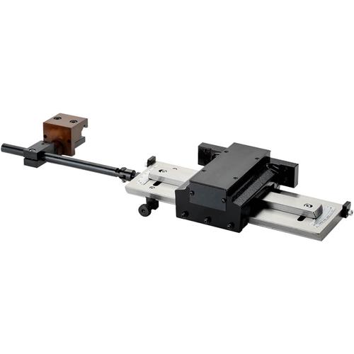

This Taper Attachment for 13", 14", and 16" Lathes features an inches-per-foot scale and a degree scale. An angle adjusting knob with fine threads achieves precise control when setting tapers. Another feature is the ability to use the taper attachment without disengaging the cross slide nut. This design allows the taper attachment to be functional at any time by simply tightening the two deadman clamp cap screws, which lock the deadman clamp to the rear lathe way.

Fairly easy to install. Glad I purchased it. Had to modify the backsplash a little bit so the attachment would clear. Very excellent quality and accurate. Very heavy.
