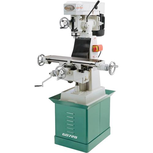

Simple, solid, and extremely accurate. This 6" x 26" Vertical Milling Machine is carefully built in Taiwan with heavy castings throughout for rigidity and accuracy. Just like larger and more expensive mills, the headstock tilts left or right 45° and rotates up to 90° in both directions, so you're not limited when it comes time to machine complex angles. To ensure maximum power for 110V operation, we used a 1-1/2 HP TEFC spindle motor. Speed changes are quick and easy with a stepped-pulley V-belt drive system. To keep table movement gliding effortlessly, all ways are lubricated with a one-shot oiler system. Available with or without longitudinal power feed. This is a very nice knee mill for those looking to step-up from a benchtop dovetail milling machine.
  • Dovetail sliding ways for accuracy
  • One-shot oiler lubrication system
  • Large stroke handle
  • Forward/Reverse switch
  • Rotating turret style column
  • Head tilts side to side
  • Precision-ground table
  • Coarse and fine downfeed controls
  • Adjustable downfeed stop system
  • Motor: 1-1/2 HP, 110/220V, prewired 110V, 1725 RPM
  • Power transfer: V-belt drive
  • Spindle taper: R-8
  • Spindle travel: 3"
  • Max. distance spindle to table: 12-1/4"
  • Max. distance spindle to column: 6-1/2"
  • T-Slots: 3 @ 1-11/16" on center, 9/16" wide
  • Table size: 26" L x 6-1/8" W
  • Table travel (longitudinal): 15-5/8"
  • Table travel (cross): 6"
  • Knee travel: 13-1/2"
  • Max. drilling capacity for cast iron: 1"
  • Head tilt: 45° left/right
  • Number of speeds: 9
  • Speeds: 230, 320, 570, 670, 1200, 1420, 1650, 2170 and 2520 RPM
  • Overall dimensions: 45-3/4" W x 68" H x 49-3/4" D
  • Approximate shipping weight: 746 lbs.
