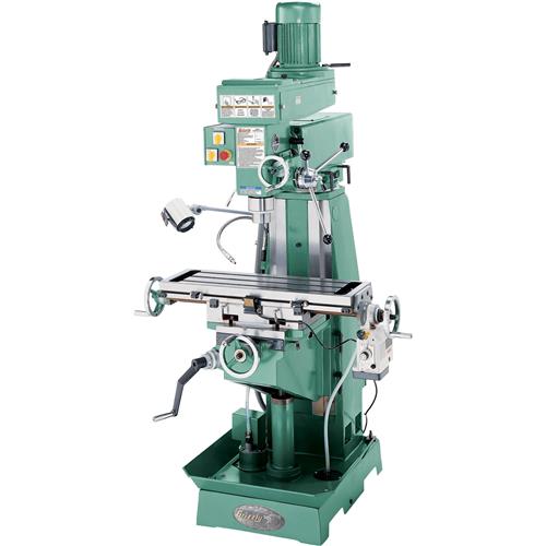

This is an extraordinary value for a vertical milling machine in this size range. It comes packed with features and capacities found on other mills costing thousands more. Start with a powerful 2 horsepower motor, coolant system and power feed on the longitudinal axis. Then add a swivelling table, an amazing 15" capacity under the spindle and a 44" maximum swing! With the heavy castings and precision ground ways, you can tackle just about any job with confidence. Includes a set of R-8 collets, milling vise and drill chuck with arbor.
Features:
- Centralized controls
- Massive Ram
- Swivel head
- Heavy castings
- Power feed
- Flood coolant
- Work light
- Spindle taper: R-8
- Spindle travel: 5"
- Table size: 9-1/2" x 31-1/2"
- Table travel (longitudinal): 15-1/2"
- Table travel (cross): 8-1/2"
- Knee travel (vertical): 13"
- Max. dist. spindle to column: 22"
- Max. dist. spindle to table: 15"
- Table swivel: 45° left and right
- Head tilt: 90° left and right
- Turret or column swivel: 90° left and right
- T-slots: 3 on 1-5/8" centers, 1/2" stud
- Number of speeds: 9
- Range of speeds: 270, 390, 550, 615, 860, 930, 1800, 1960 and 2950 RPM
- Motor: TEFC capacitor start induction
- Voltage: 110V/220V
- Phase: Single-Phase
- Horsepower: 2
- RPM: 1725
- Power Transfer: V-Belt drive
- Overall Height: 81"
- Shipping weight approx.: 1996 lbs.
