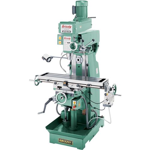

Grizzly G3617 - Horizontal / Vertical Mill
Built to the same exacting tolerances and heavy-duty construction as the G3616 Vertical Mill, this machine also adds a horizontal spindle. Cut slots, gears or gang mill with this beauty, then do all the jobs that require a vertical spindle, too! Switching from one spindle to the other is quick and easy and both have their own powerful motors. The coolant system, power feed and work light makes this machine a joy to use.
Features:
  • Centralized motor controls
  • Massive ram casting
  • Swivel head
  • 72 - 1300 RPM horizontal spindle speed
  • Power feed
  • Flood Coolant
  • Work light
  • Spindle tapers: R-8
  • Spindle travel: 5"
  • Table size: 9-1/2" x 39-3/8"
  • Table travel (longitudinal): 22"
  • Table travel (cross): 8-1/2"
  • Knee travel (vertical): 13"
  • Max. dist. spindle to column: 27"
  • Max. dist. spindle to table: 13-3/4"
  • Max. dist. horizontal spindle center to table: 11-3/8"
  • Vertical head tilt: 90° left and right
  • Turret or column swivel: 180°
  • T-slots: 3 on 3" centers, 1/2" studs
  • Vertical spindle speeds: 9
  • Range of speeds: 270, 390, 490, 615, 860, 930, 1600, 1960 and 2950 RPM
  • Horizontal spindle speeds: 8
  • Range of speeds: 72, 170, 210, 240, 290, 550, 830 and 1300 RPM
  • Horizontal arbor sizes: 1" & 1-1/4"
  • Vertical motor: 2 HP, 110V/220V, single-phase, 20/10 Amps, TEFC
  • Horizontal motor: 1-1/2 HP, 110V/220V, single-phase, 16/8 Amps, TEFC
  • Power Transfer: V-Belt
  • Overall Height: 80-3/4"
  • Shipping weight approx.: 2429 lbs.
