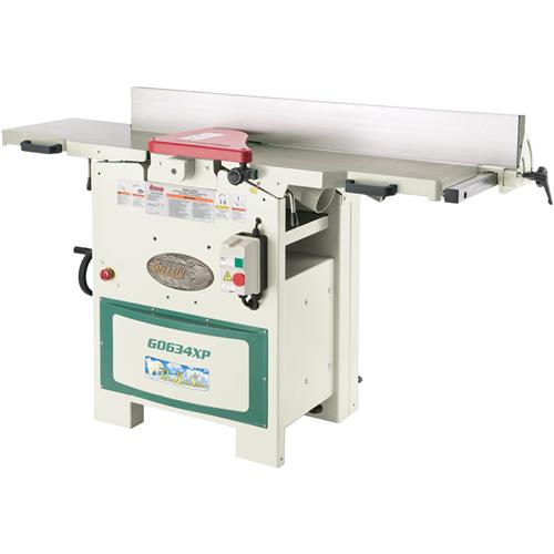

This Combination Machine is similar to the G0634Z, except it sports our popular Polar Bear colors. It also has an end-mounted fence, so you can work as close to your shop wall as possible. This feature is a real space saver, and since this is a combination machine, you're saving shop space already. You'll also love the 12" wide jointer capacity, spiral cutterhead, and quick conversion from jointer to planer. For squaring up both sides of lumber up to 12" wide, you can't beat this machine!
  • Motor: 5 HP, 220V, single-phase, 25A
  • Jointer table size: 14" x 59-1/2"
  • Cutterhead: Spiral, 32 inserts
  • Cutterhead insert size: 15 x 15 x 2.5mm
  • Cutterhead diameter: 3-1/8"
  • Cutterhead speed: 5034 RPM
  • Maximum jointer depth of cut: 1/8"
  • Maximum width of cut: 12"
  • Cuts per minute: 20, 136
  • Fence: 6" x 51-1/4"
  • Bevel jointing: 0° - 45°
  • Switch: Magnetic with thermal protection
  • Power transfer: Twin V-belts
  • Bearings: shielded and lubricated
  • Floor-to-table height (Jointer): 35-1/2"
  • Dust port size: 4"
  • Planer feed rate: 22 FPM
  • Maximum planer depth of cut: 1/8"
  • Maximum planer cutting height: 8"
  • Planer table size: 12-1/4" x 23-1/8"
  • Overall size: 67-1/2" W x 24" D x 41-1/2" H
  • Footprint: 26" x 19-1/2"
  • Approximate shipping weight: 704 lbs.
