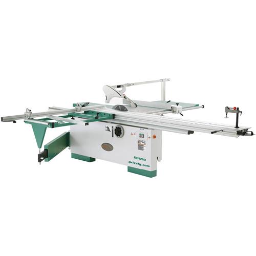

This 12" Slider has all the features of its 14" bigger brother, the G0493, including the amazing ability to cross-cut or rip-cut up to 126", meaning this saw has the largest cutting capacity out of any 12" Sliding Table Saw that we carry! But that's not all that makes this saw great--it also has an independent scoring blade motor that allows the main motor to focus all power on cuts up to 3-5/16" thick. A see-through, fully-enclosed blade guard is also standard equipment, so you don't have to sacrifice optimal dust collection for safety. Of course, just like the big boys, this saw also features a riving knife that moves up and down with the blade, a micro-adjustable rip fence for traditional table saw cuts, and an extruded aluminum, extendable crosscutting fence with two very solid flip stops. Best of all, this saw has the capabilities and options only found in much more expensive machines.
  • Micro adjustable rip fence
  • Scoring saw blade ensures tear-out free cutting
  • Sliding table on bearing guide system with hardened steel ways
  • Blade tilts 45° for miter cutting
  • 5" main dust hood, 4" upper dust hood
  • Aluminum alloy crosscut fence for miter cutting 45°right and left
  • Miter fence has two swing stops for repetitive cutting
  • Safety limit switch for blade cover
  • Adjustable riving knife adjustment
  • Belt drive
  • Cast-iron trunnions
  • Main motor: 7-1/2 HP TEFC, 220V/440V*, 3-phase, prewired for 220V
  • Scoring motor: 1 HP TEFC, 220V/440V*, 3-phase
  • Power transfer: V-belt
  • Main blade size: 12"
  • Main blade arbor: 1"
  • Main blade tilt: 0-45°
  • Main blade arbor speed: 4000 RPM
  • Depth of cut at 90°: 3-5/16"
  • Depth of cut at 45°: 2-3/8"
  • Scoring blade size: 4-3/4"
  • Scoring blade arbor: 20mm
  • Scoring blade arbor speed: 8000 RPM
  • Scoring blade tilt: 0-45°
  • Sliding table size: 126" x 14"
  • Length of cross cut: 126"
  • Maximum rip capacity: 49-3/4"
  • Maximum sheet capacity: 126" x 126"
  • Main table dimensions: 35-1/4" x 21-1/2"
  • Dust ports: 2-1/2" and 5"
  • Approximate shipping weight: 1468 lbs.
