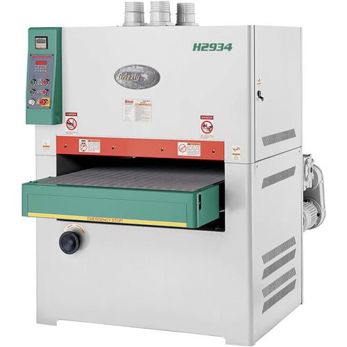

Rarely can a machine claim to cut your sanding time in half, but our Double Head Wide-Belt Sanders feature dual heads enabling them to sand to finer grits in a single pass! The first belt runs on a single drum and the rear belt runs on a platen system which allows you to adjust the sanding depth. If you are still sanding through 2 grit levels using a single head wide-belt sander you are not being the most efficient. CSA certified meeting CSA C22.2 #71.2-08 and UL 987-7 standards!
Features:
  • Rubber pressure rollers
  • Hard rubber infeed drum
  • Adjustable graphite platen
  • Digital encoder depth control
  • Amp/load meter
  • Disc brake for emergency stop
  • Variable feed speed
  • Made in an ISO 9001 Factory!
  • Sanding motor HP: 20 HP, TEFC
  • Sanding motor voltage: 220V/440V*
  • Sanding motor phase: 3-phase
  • Sanding motor amps: 50.3A/25.1A
  • Conveyor motor HP: 1 HP, TEFC
  • Conveyor motor amps: 3.4A/1.7A
  • Table lift motor HP: 1/4 HP, TEFC
  • Table lift motor amps: 1.2A/0.6A
  • Footprint: 52" x 31"
  • Maximum board width: 36-1/2"
  • Maximum board thickness: 6"
  • Minimum board length: 14"
  • Minimum board thickness: 3/16"
  • Front drum surface speed: 3500 FPM
  • Rear drum surface speed: 2600 FPM
  • Conveyor speed: 14–60 FPM
  • Sanding belt size: 37" x 60"
  • Air requirement: 57 – 75 PSI, 12.3 CFM
  • Overall width: 54"
  • Overall height: 71-1/2" H
  • Overall depth: 59-1/2"
  • Dust ports: 6
  • Approx. shipping weight: 2461 lbs.
