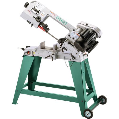

This Metal-Cutting Bandsaw is perfect for the small shop with three cutting speeds, automatic shutoff and vertical cutting attachment and maximum 4-1/2" round and 4-1/2" x 6" rectangular cutting capacity.
Features:
  • Blade included
  • Automatic shutoff
  • Three cutting speeds
  • Ball bearing construction
  • Vertical cutting attachment
  • Handles and wheels for portability
  • Motor: 3/4 HP, 110V, single-phase, 1725 RPM
  • Max. capacity circular: 4-1/2" dia.
  • Max. capacity rectangular: 4-1/2" x 6"
  • Blade speeds: 78, 108, 180 FPM
  • Included Blade size: 64-1/2" x 1/2" x 14 TPI
  • Approx. shipping weight. 127 lbs.
