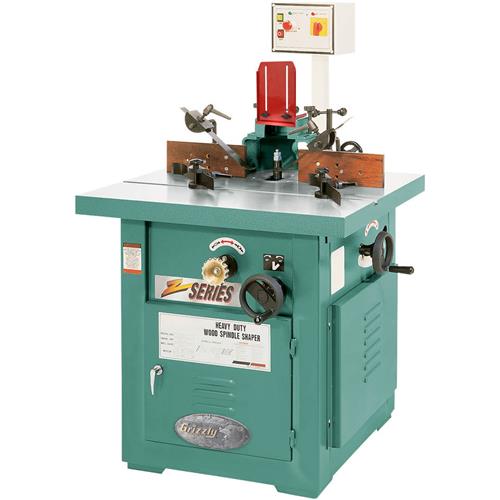

If you need moulding profiles in hardwoods that you can't find at your local millwork supplier, we think you'll find our new 7-1/2 HP 3-Phase Tilting Spindle Shaper worthy of your consideration. Built to withstand the rigors of industrial production, this impressive shaper will cut more profiles than you can shake a stick at. The unique tilting spindle will add even more variety and utility to your shaping operations and the conveniently located controls and adjustments make this machine a joy to operate.

  • Tilting spindle allows for infinite profile possibilities with your existing shaper cutters
  • Spindles include spacer and nuts
  • Four spring steel hold-down assemblies
  • Cast-iron miter gauge, adjustable 60° left/right
  • Powder-coated finish
