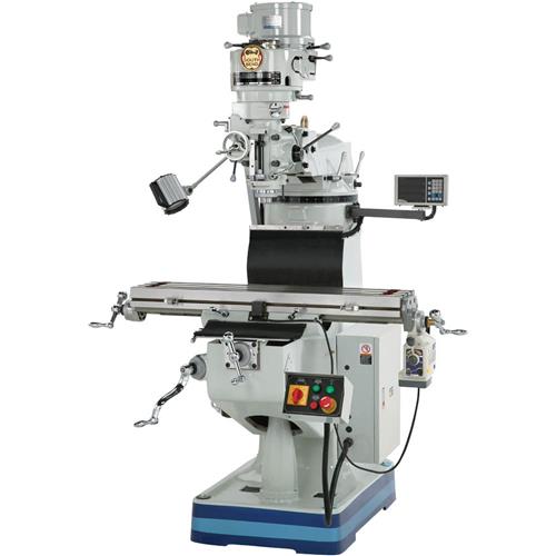

All the precision you could ever need has been masterfully executed in these new South Bend® milling machines. Choose from the 8 speed single phase or the 16 speed 3-phase mill & get the uncompromising quality you've come to expect. No detail has been left to chance: rigid Meehanite castings, hardened & precision-ground table, chromed quill, silky smooth spindle rotation on precision bearings & Turcite coating on the ways, just to name a few! These machines are built to last for many years to come & will provide accurate performance all along the way. Beautiful South Bend® light gray & two-tone blue color scheme.
  • Table size: 9" x 42"
  • Longitudinal travel: 24-1/2" with power feed, 29-1/2" without power feed
  • Cross travel: 13"
  • Vertical (knee) travel: 16"
  • Table T-slots: (3) 5/8"
  • Maximum workpiece weight: 750 lbs.
  • Spindle motor: 2 HP, 3-phase, 220V, 60 Hz
  • Spindle taper: R-8
  • Spindle speeds: 80–5600 RPM (variable; 16 steps)
  • Spindle nose to table: 0"–18"
  • Spindle centerline to column surface: 6"–19"
  • Quill travel: 5"
  • Automatic vertical feeds (per revolution): 0.0015", 0.003", 0.006"
  • Head swivel: (L & R) 90° & (F & R) 45°
  • Ram travel (In/Out): 13"
  • Ram swivel: 180°
  • Approximate shipping weight: 2161 lbs.
  • Net machine weight: 1940 lbs.
  • Overall dimensions: 63" W x 81" H x 58" D
Features:
  • Allen Bradley® controls
  • Japanese NSK/NTN bearings
  • Table, knee and ram are equipped with dual locking mechanisms
  • Balanced spindle and high-precision P4 (ABEC-7) bearings for smooth, quiet and precise operation
  • Turcite-coated ways
  • Each machine comes with its own QC report for tested tolerances
  • South Bend® brass nameplate
  • Meehanite® casting
  • Built in the typical South Bend® “no compromises” fashion
