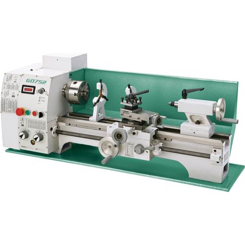

G0752 10" x 22" Variable-Speed Lathe
A great benchtop metal lathe for turning tools and parts.
The G0752 10" x 22" Variable-Speed Lathe should be a welcomed addition to your garage or workshop.
The variable-speed spindle control with a digital RPM readout on the headstock allows you to dial in the exact spindle speed you need between 100–2000 RPM with the turn of a dial.
The beds are constructed have been precision-ground and hardened in the traditional three-V prismatic design.
The carriage has power feed capability when it is engaged with the lead screw.
The spindle has an MT#4 taper and 25mm bore. The tailstock quill offers 2-1/2" of travel and has a MT#3 taper.
The optional T27838 or T27839 Cabinet Stands allow for a more organized and stable base for turning operations.
  • Required power source: 110V, single-phase, min. 12A circuit
  • Motor: 1 HP, 110V
  • Swing over bed: 9-1/2"
  • Swing over cross slide: 6-1/8"
  • Swing over saddle: 6-1/8"
  • Distance between centers: 22"
  • Bed width: 6-1/8"
  • Spindle speed: Variable, 100–2000 RPM
  • Spindle type: 1-3/4" x 8 TPI
  • Tailstock taper: MT#3
  • Tailstock quill travel: 2-1/2"
  • Cross slide travel: 6-1/2"
  • Compound travel: 3-1/2"
  • Maximum tool bit size: 1/2"
  • Leadscrew: 3/4" x 12 TPI
  • Longitudinal feeds: (9) 0.0025, 0.0140 in./rev.
  • Inch thread range: (31) 8–72 TPI
  • Metric thread range: (26) 0.25–3.50mm
  • Footprint: 47-1/2" x 12-1/2"
  • Overall dimensions: 50-1/2" W x 22" D x 19-5/8" H
  • Approximate shipping weight: 453 lbs.
  • Variable-speed spindle control with digital RPM readout
  • Spindle reversing switch
  • Hardened and ground V-way bed
  • Oil-bath gearbox
  • Emergency stop button
  • Chip tray and backsplash guard
INCLUDES:
  • 5" Three-jaw scroll chuck with two sets of jaws
  • 6-1/2" Four-jaw independent chuck with reversible jaws
  • 8" Faceplate
  • 4-Way turret tool post
  • MT#3 and MT#4 dead center
  • Follow and steady rests
