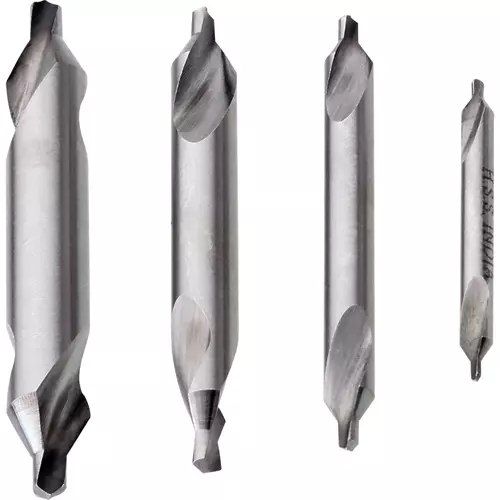

H5930 4-Piece 60° Center Drill Set
The H5930 Center drills consist of a pilot drill and a 60° countersink on each end.
60° is the most common live center angle.
These center drills are used to cut holes in the center of a piece of stock on a metalworking lathe.
The double ended H5930 HSS Center Drills are precision ground and includes sizes 1-4.
  • Material: High-speed steel
  • Angle: 60°
  • Size 1: Body Dia. 1/8", Drill Dia. 3/64", O.A. Length 1-1/4"
  • Size 2: Body Dia. 3/16", Drill Dia. 5/64", O.A. Length 1-7/8"
  • Size 3: Body Dia. 1/4", Drill Dia. 7/64", O.A. Length 2"
  • Size 4: Body Dia. 5/16", Drill Dia. 1/8", O.A. Length 2-1/8"
