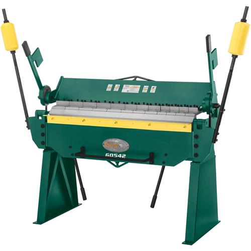

G0542 48" Pan and Box Brake 12-Gauge
The best value in Pan and Box Brakes.
The G0542 48" Pan and Box Brake is perfect for some heavy-duty box bending. It will easily set an angle in 12-gauge mild steel up to 135°.
Setting the adjustable stop collar allows you to make repeatable bends at an exact angle. This is especially useful when making stackable pans.
The adjustable brake handle is counterweighted to add leverage to ease the effort needed to bend thicker workpieces.
The G0542 comes with eight removable fingers for box forming and other special bending operations. The fingers can be used individually or all at once.
This Pan and Box Brake is built to last a lifetime. Constructed from steel, it weighs in at 1,254 pounds.
Like all Grizzly pan and box brakes, the G0542 comes with a 1-year warranty which covers parts and assures the unit is free from factory defects.
The G0542 manual was written by our U.S.-based Technical Documentation Department and is packed with useful information. The complete and easy-to-read manual makes it easier to assemble and maintain your pan and box brake.
  • Sheet metal capacity half width: 12-gauge mild steel
  • Sheet metal capacity full width: 14-gauge mild steel
  • Brake range: 0-135°
  • Minimum reverse bend: 1/2"
  • Maximum height of pan/box sides: 6"
  • Finger sizes: (1) 25", (3) 4", and (4) 3"
  • Footprint: 53-1/4" x 29-1/4"
  • Overall size: 83" W x 29" D x 69" H
  • Approximate shipping weight: 1271 lbs.
