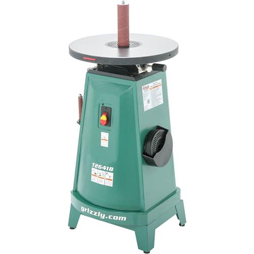

Grizzly T26418 - Floor-Model Oscillating Sander
With the same great features as its benchtop counterpart—the T26417—but with larger specs to complement its larger frame, this oscillating spindle sander with stand is sure to grab your attention! Weighing in at 126 lbs. and standing 36-3/4" tall from floor to table, with a 20-1/4" x 19-5/8" footprint, this machine will make a statement in any shop. Features a 20" diameter, 45° tilting, cast-iron table, a 2-1/2" dust port, built-in storage for sanding drums and table inserts, wrenches for changing spindles, and rubber feet for optimum stability.
SPECIFICATIONS
  • Motor: 1 HP, 110V, single-phase, 6.9A
  • Table size: 20" Diameter
  • Spindle speed: 1725 RPM
  • Spindle stroke: 1-3/16"
  • Spindle oscillations: 52 OPM
  • Spindle diameter: 10, 16mm
  • Sanding drum lengths: 4-1/2", 9", 9"
  • Sanding drum diameters: 3/4", 2", 3"
  • Dust port size: 2-1/2"
  • Footprint: 19-5/8" x 20-1/4"
  • Overall dimensions: 20-1/4" W x 19-5/8" D x 45-1/2" H
  • Approximate shipping weight: 143 lbs.
  • 45° table tilt
  • Built-in storage for sanding drums and table inserts
  • Cast-Iron table
  • Rubber feet
INCLUDES:
  • (3) Rubber sanding drums
    • 4-1/2" long, 3/4" diameter
    • 9" long, 2" diameter
    • 9" long, 3" diameter
  • (3) 100-Grit sanding sleeves
  • (6) Table inserts
  • Spindle wrenches
